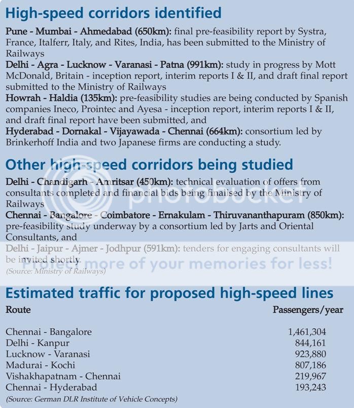

-Diamond Quadrilateral:
Contract Awarded for the Consultancy of Feasibility study for Diamond Quadrilateral network of High Speed Rail Corridors
a) Delhi-Mumbai (Package-I)
Feasibility Study Contract awarded to a Consortium of M/s The Third Railway Survey and Design Institute Group Corporation (CHINA) and Lahmeyer International (India) Pvt. Ltd, India
b) Mumbai-Chennai (Package-II)
Feasibility Study Contract awarded to a Consortium of M/s SYSTRA (FRANCE) - RITES- Ernest &Young LLP.
c) Delhi-Kolkata (Package-III)
Feasibility Study Contract awarded to a Consortium of M/s INECO (SPAIN) - M/s TYPSA- M/s Intercontinental Consultants and Technocrats Private Limited
-Delhi-Chennai:
Delhi-Nagpur section of this corridor is being taken up as Phase I under Government to Government cooperation. Planning study report for this High Speed Rail Corridor by China Railway SIYUAN Survey and Design Group Co. Ltd has been completed. Project Feasibility Study is yet to be taken up by SIYUAN. High Speed Rail Corporation of India Ltd is the counterpart agency.
De todas formas, la que parece que será la primera LAV (para 2024), está fuera del Diamond Quadrilateral y conectará Mumbai y Amehdabad a lo largo de 508 km con una velocidad de diseño de 350 km/h que reducirá el trayecto de las 7 h 30 m actuales a solo 2 h, a 254 km/h de media con una inversión de 18,83 M € por km. El estudio ha sido realizado por India’s Research Designs & Standards Organisation and Japan’s Railway Technical Research Institute, los cuales han aconsejado que se utilice ancho estándar.

Propuestas y estimaciones (¡basadas en los números del transporte aéreo!) del German DLR Institute of Vehicle Concepts en 2009:
